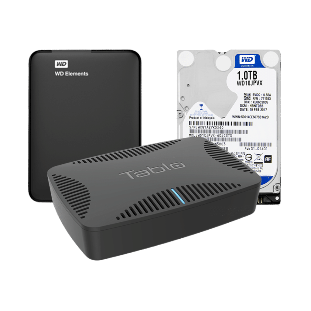

Which USB Hard Drives are compatible with Tablo OTA DVRs?
Tablo OTA DVRs support USB hard drives with either USB 2.0 or USB 3.0 connections. That said, USB 3.0 drives and solid state drives don’t offer any speed or performance benefits so it’s not necessary to shell out extra cash for those features.
We recommend Western Digital Elements drives and Seagate Expansion drives for use with your Tablo OTA DVR, but most other brands/models are compatible.
wd drive
If you’re considering an alternate model of hard drive, be sure to check out the reviews and avoid drives with reported problems like frequent disconnects which can cause failed recordings.
Non-Compatible Forms of Storage to Avoid for Tablo OTA DVRs:
Tablo OTA DVRs do NOT support USB Flash Drives (aka sticks) or Network Attached Storage (NAS). That’s because their read/write speeds are too variable for recording live video.
no flash drives for tablo ota dvr
Also, Tablo does NOT support third-party internal hard drives placed in external enclosures as they can cause frequent USB disconnects and communication issues.
