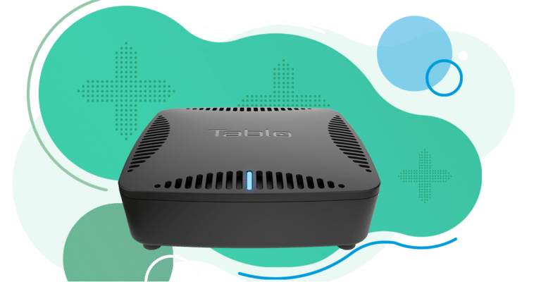

    Check your Tablo’s LED.
    If the LED light on your Tablo is solid blue, it is connected to your network. If the light is flashing or off, additional troubleshooting is required.
