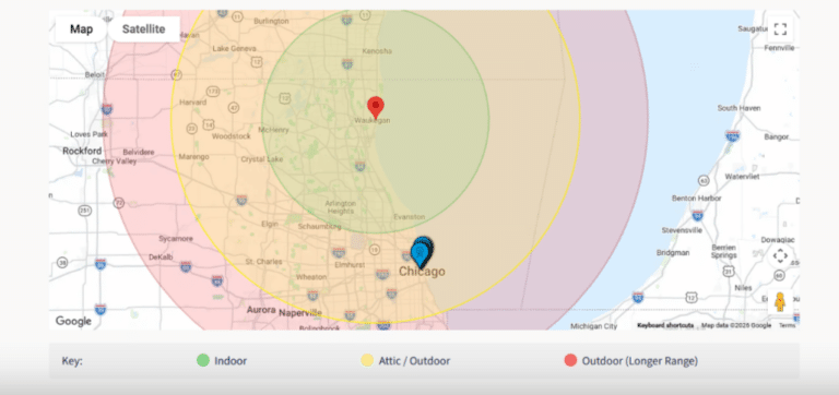

LOCATION FACTOR #1 - Proximity to Local Broadcast Towers
Ideal reception areas for antenna TV are within 35 miles of local broadcast towers. However, under normal atmospheric conditions and depending on your antenna equipment, placement and other factors, TV signals can be received up to 70 miles away. Beyond 70 miles, signals are blocked by the curvature of the earth and cannot reach any TV antenna.
If you’re living closer or further away from your local broadcast towers after moving, you may need to swap out your old TV antenna for one that better suits your current needs.
Not sure where your local towers are? Use our online tool here.
