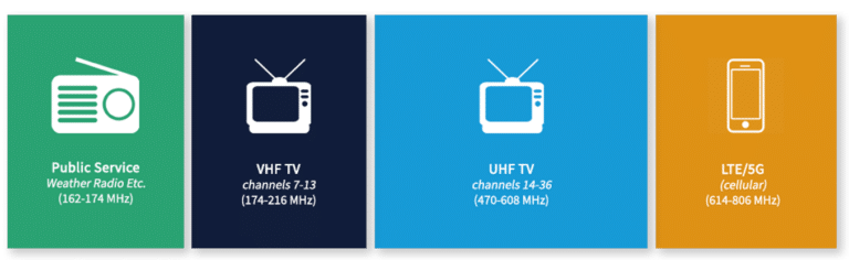

Just like screens on your windows allow fresh air to pass through but block mosquitoes, LTE and 5G filters work to block the unwanted frequency range of cellular signals while allowing the adjacent TV broadcast signals to reach your television or Tablo’s tuner.
Graphics showing devices and their frequencies. Public Services, Weather Readio Etc: 162-174 MHz. VHF TV channels 7-13: 174-216 MHZ. UHF TV, channels 14-36: 470-608 MHZ. LTE/5G, cellular: 614-806 MHz.
Filtering out the undesirable frequencies can improve reception.

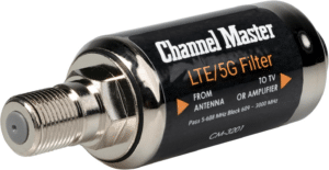

A variety of LTE/5G filter options are available from major online retailers for as little as $15-30.
Look for filters that specify a 5-608 MHz or 5-695 MHz pass band to ensure they don’t block legitimate TV signals. Higher quality, name brand filters typically provide lower signal loss, better shielding to prevent external interference and sharper filtering especially at the edges of the frequency bands when compared to budget options.
Installation and Testing
Installing an LTE/5G filter is straightforward. Simply connect one end to your TV antenna’s coaxial cable and the other end to your Tablo’s coaxial port. If you don’t notice better reception within a day or two of installation, your issue likely isn’t cellular interference.
