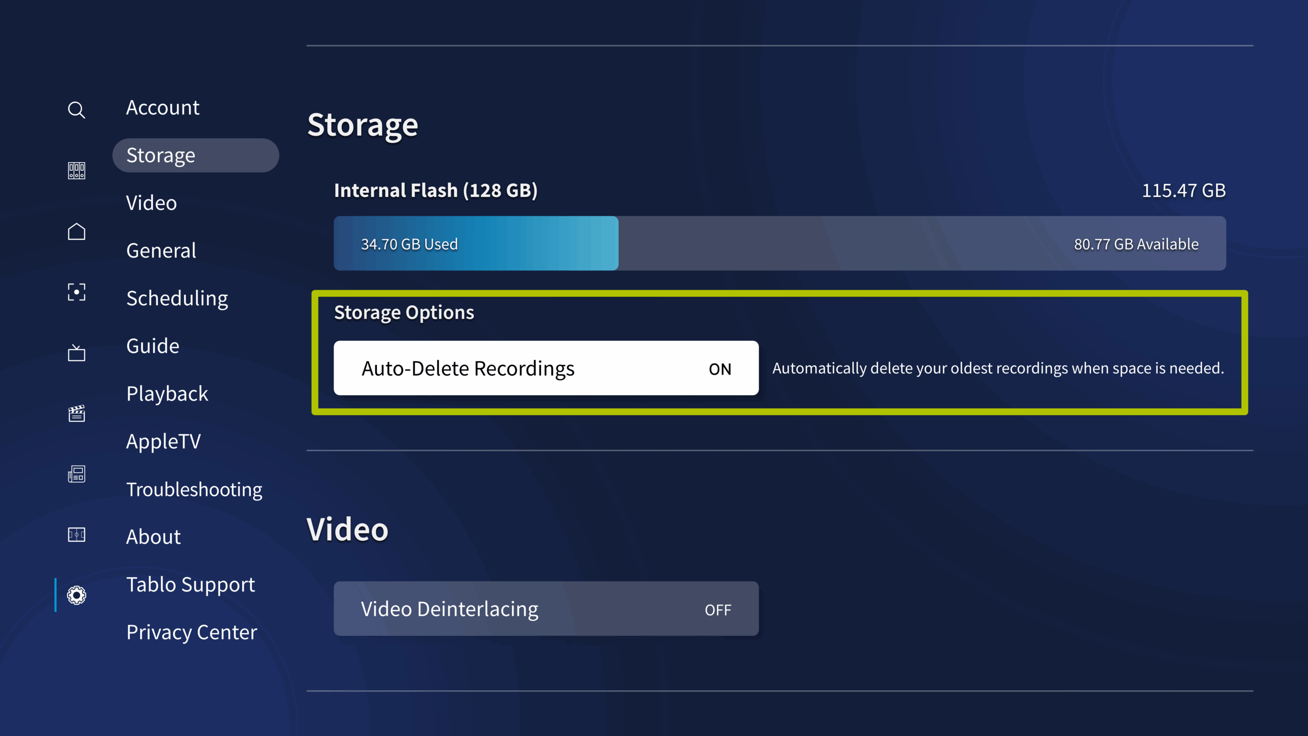

How Auto-Delete Is Tuned
Storage setting on a 4th Generation Tablo. Storage Options - Auto Delete Recordings ON is highlighted.
The auto-delete feature is adjusted based on the size of your Tablo’s onboard memory or USB-connected hard drive, as well as the number of tuners it has.
When using onboard storage, Tablo will maintain 2 hours of free storage per tuner. On larger USB-connected drives, a larger amount of free storage will be maintained.
Each live TV channel being watched will also reserve an additional hour of space.
While you can see details about how much recording storage space is being used within the SETTINGS and LIBRARY screens of the Tablo app, this reserved space isn’t reflected. So even if you think you have several GBs of storage remaining, the total available amount could be much smaller.
