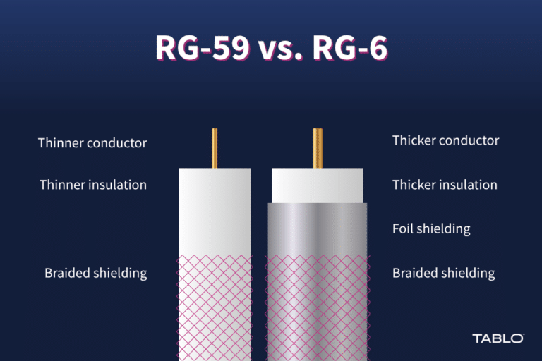

Let’s take a closer look at the differences:
RG-59 vs. RG-6 showing the differences between the two. RG-59: Thinner conductor. Thinner insulation. Braided shielding. RG-6: Thicker conductor. Thicker insulation. Foil shielding. Braided shielding.
  • Intended applications — RG-6 coaxial cable is designed to deliver modern digital signals and is best for home theater applications. RG-59 is designed for older analog signals and is best for applications like video security systems.
  • Materials & Construction — RG-6 coaxial cable has a thicker conductor wire, better insulation and two layers of shielding. RG-59 cabling is thinner and only offers a single layer of shielding.
  • Signal Loss & Interference Protection – The thicker insulation and extra shielding in RG-6 cabling helps prevent interference and signal loss ensuring your over-the-air signal stays strong and clear as it moves from your antenna to your television or Tablo. Thinner insulation and single-layer shielding in RG-59 cabling can lead to noticeable signal loss, especially over longer distances and the potential for interference leading to issues with playback and recording of over-the-air TV.
  • Flexibility — The downside of the better-quality materials in RG-6 cabling is that it’s much less flexible than thinner RG-59 coax. It can be harder to make RG-6 cabling look tidy without using cable management tools.
  • Price — You can expect to pay a premium for the benefits RG-6 cabling It’s approximately 11 cents more per linear foot than RG-59.

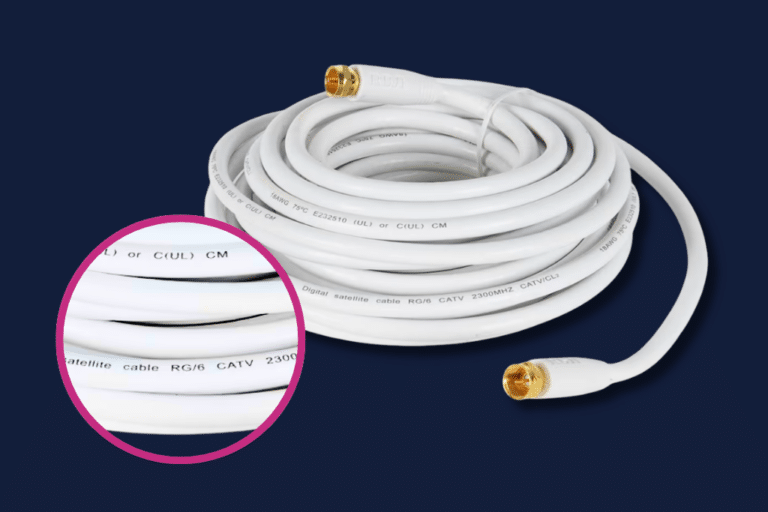

If you’re not sure what type of coaxial cabling connects your TV antenna to your Tablo, it’s easy to find out. Look closely for a printed label on the outside of the cable itself. It should specify whether your cabling is RG-6 vs. RG-59.
If you’re using the TV antenna and cabling included with the Tablo Total System, it’s RG-6.
If you don’t see a label and the cabling is very thin, it could be ultra-fine or micro coaxial cabling. This extra thin cabling is common in lower-quality TV indoor TV antennas, especially models with integrated coaxial cable. While it’s super flexible and lightweight, its minimal insulation and shielding mean poorer performance in anything but short cables.

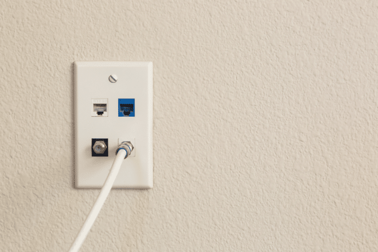

Swapping out a short, fully exposed RG-59 cable for RG-6 is simple and takes less than 5 minutes. However, replacing long run of coaxial cabling installed within your walls or along the baseboards of your home can be a daunting, but potentially worthwhile task if you’re dedicated to improving your antenna TV setup.
