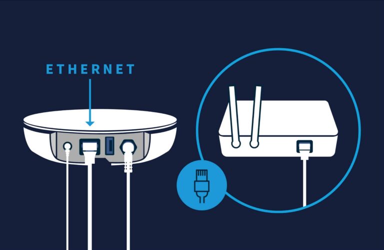

Tablo Device Connections - Ethernet
STEP 3 - Connect the Ethernet cable (optional).
The included Ethernet cable has plastic connectors at both ends that look like phone jacks.
If the best location for your TV antenna is also near your home’s Wi-Fi router, you should choose to connect your Tablo device to the internet using Ethernet.
Connect one end to your home’s Wi-Fi router and the other to the Ethernet port on the left side of the back of your Tablo.
Skip this step if your Wi-Fi router is not nearby.
TIP – Connecting your Tablo device via Ethernet is easier and will offer more stable performance than connecting it via Wi-Fi.

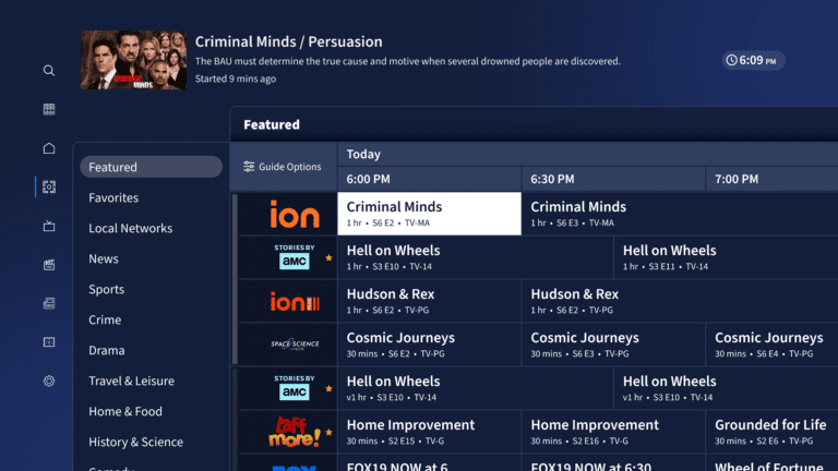

Tablo new CBG Guide screenshot
Live
A familiar grid-style guide for watching live TV and seeing what’s on now and over the next two weeks.
TIP – Select the channel ID from the far left of the live TV grid to start playing your selected channel immediately.

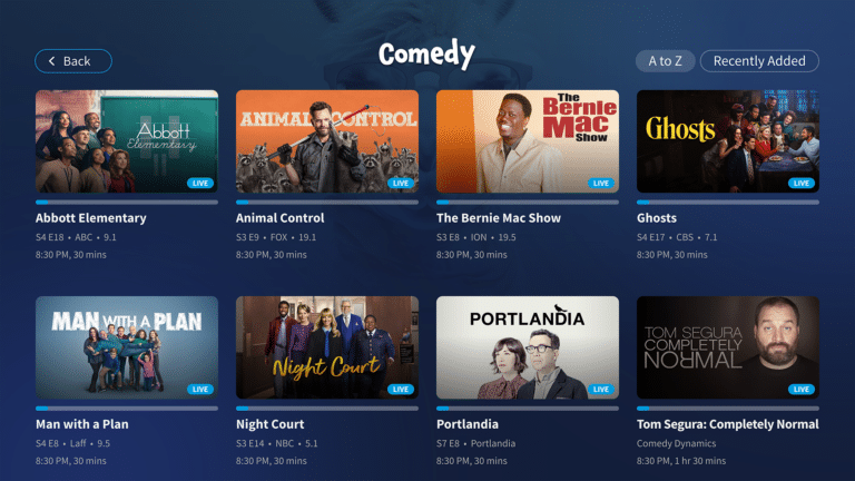

Tablo Shows Genre Comedy
TV Shows, Movies & Sports
Browse live and upcoming programs in these streaming-style guides and set your favorite series to record.
TIP – Filter by genre, channel or sport to discover new or old favorites to watch or record.
