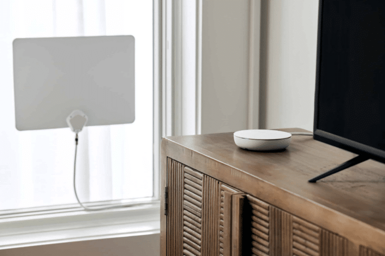

Today’s question comes from Kevin who says, “We’ve been using Tablo with an indoor antenna in our living room window for a year. We recently had new windows installed and when we put the TV antenna back up, the reception was terrible. We moved it to a nearby wall which helped but it’s still not great. Why is this happening and how can we fix it?”
Placing indoor TV antennas in a window facing your local broadcast towers is a common recommendation. In most cases, this will provide an ideal and unobstructed line-of-sight ensuring your TV antenna can capture a strong over-the-air signal.
However, some windows are manufactured or treated with a thin metallic membrane for energy efficiency. Unfortunately, that membrane will also block over-the-air TV signals

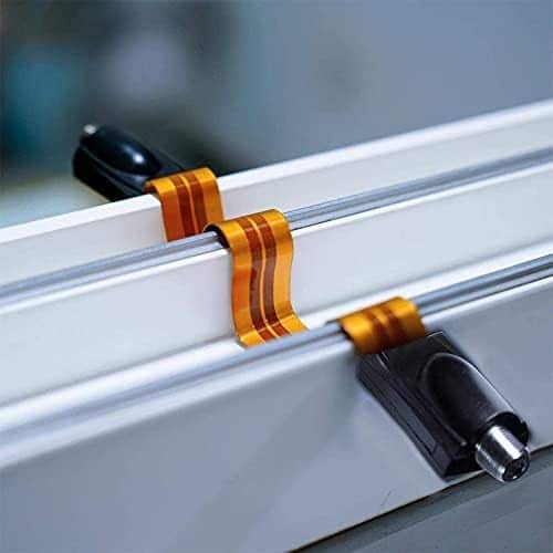

    If your TV antenna is also rated for outdoor use, you can simply swap your inside mounting position to outside the window. An accessory called a flat coaxial connector makes this super easy, allowing you to pass the antenna’s coaxial cable through a closed window or patio door. No tools required!
