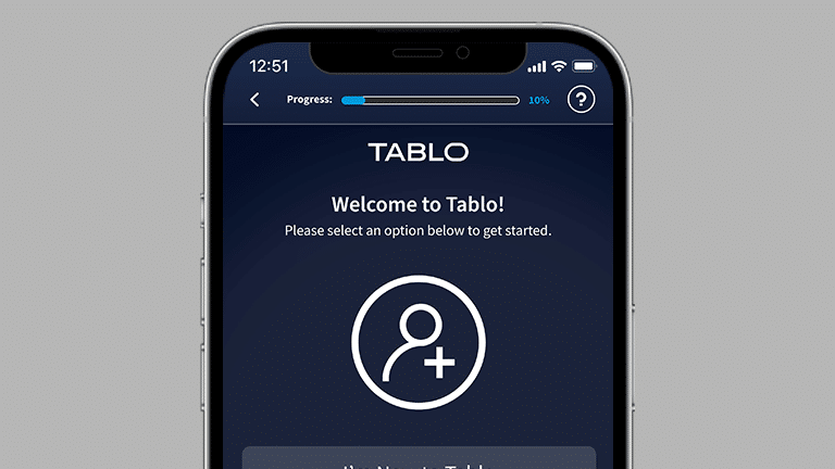

For Tablo Wi-Fi setup, use a mobile device.
Initial setup of your Tablo device requires that you download the Tablo app on a smartphone or tablet. Setup cannot be done on a Smart TV, streaming device, or PC.

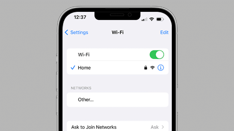

Verify that your mobile device is connected to your home newtork.

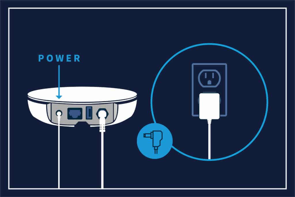

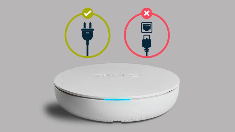

Power your Tablo up, but make sure it isn't connected to your router via Ethernet.
Make sure your Tablo is connected to a power outlet and that the Ethernet cable is NOT connected. Setup via Wi-Fi cannot proceed if the Tablo does not have power or is connected to your router via Ethernet.

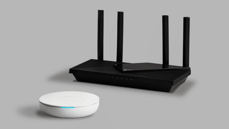

Place your Tablo near your router.
Placing your Tablo near your router during the Wi-Fi setup helps ensure a strong, consistent connection which is required for this process. You can move it closer to your TV antenna when setup is complete.

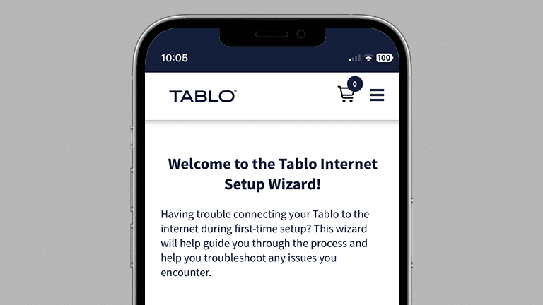

Tablo Wi-Fi Wizard
The internet setup wizard is an online companion to the Tablo app for first-time setup. The wizard interfaces with your Tablo device and the Tablo servers at HQ to provide real-time instructions and troubleshooting to help you get your Tablo connected.
