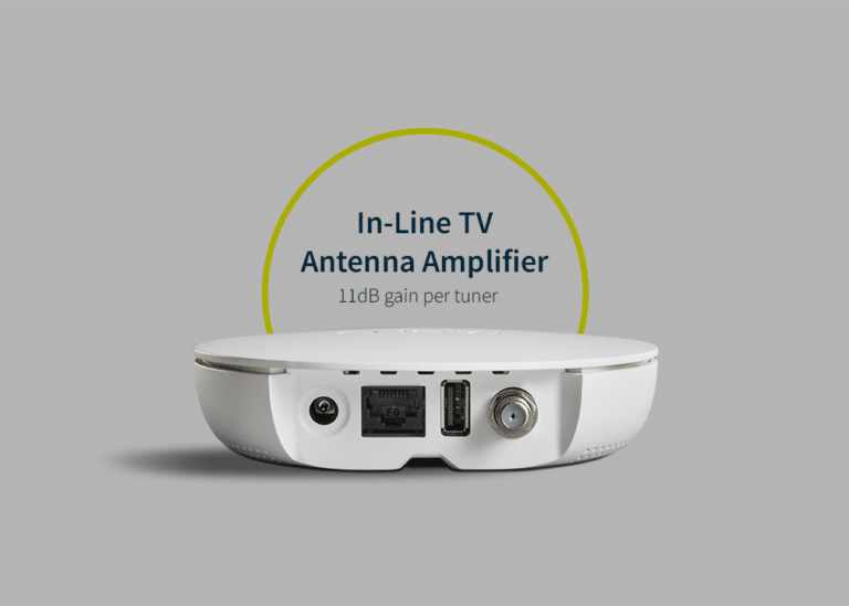

Rear of Tablo product with feature highlight text of in-line amplifier
The optional in-line amplifier is built right into the Tablo device itself. It provides a slight boost to the over-the-air TV signals coming from your antenna to the tuners inside Tablo.
(It’s an 11dB gain per tuner for those who understand what that means.)
This feature is enabled by default but can be disabled within the SETTINGS screen of your Tablo app.

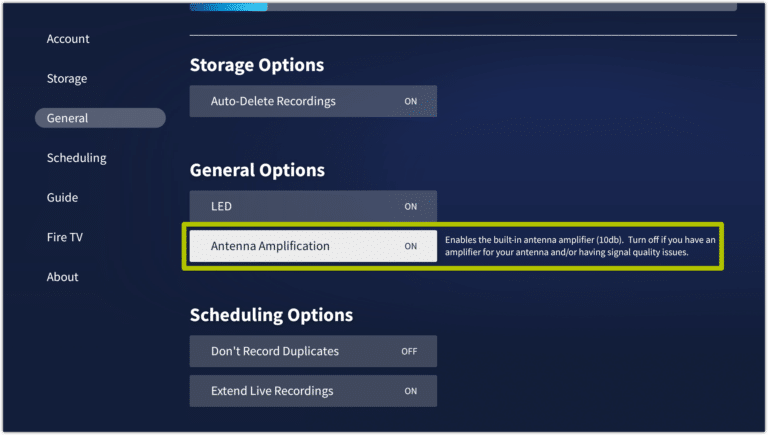

Reasons to Disable the In-Line Amplifier on Tablo
Tablo interface showing in-line amplifier toggle
While it might seem like boosting your TV antenna’s signal is always a good thing, there are situations where it could hurt your reception.
If you live within 10 miles of your local TV broadcast towers, using the in-line amplifier could overload the Tablo tuners by sending too strong of a signal. This can result in poor reception or even the inability to watch and record some channels.
In that case, turning off the amplifier in the SETTINGS screen of the Tablo app and running a fresh channel scan should improve your experience.
This can also occur if the TV antenna you’re using is already an amplified model, or if you’re using an external amplifier. In that case, you should also disable this setting on your Tablo device for the same reasons.
